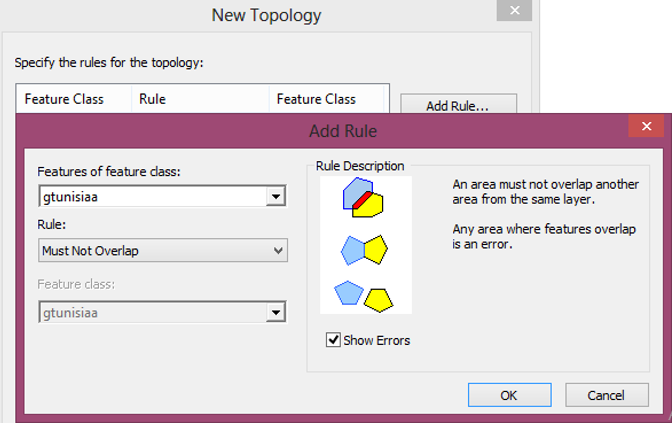

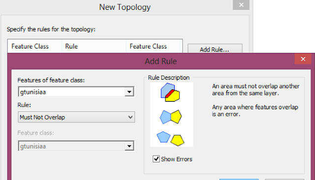

  • Now choose a series of topology rules to structure the spatial relationships between features and to control and validate how features share geometry
  • We can choose from a list of many topology rules, depending on the relationships we want to set.
  • Polygon rules :
    • Must Not Overlap: Features in this rule must not overlap another feature in the same layer.
    • Must Not Have Gaps: If we have a data that must completely cover an area, we can use this rule to display an error when there is a voids within a single polygon or between adjacent polygons.
    • Must Not Overlap With: This is used when we have two layers or more! We select this rule when we like to display errors of features which overlap another features in another layer.
