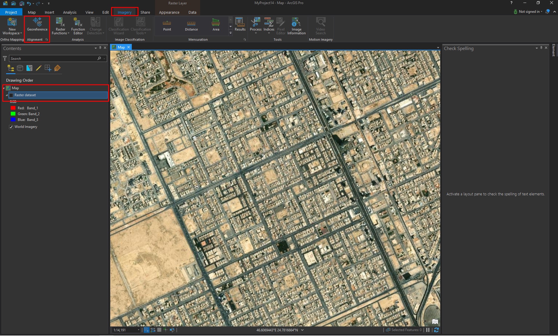

1. Add raster dataset you want to georefrence in ArcGIS Pro.
2.Select the raster dataset layer in the content pane which you want to Georefrence.
3. Select Imagery tab and then Georefrence tab in order to open Georefrencing tab.
4. Georefrence tab is divided into different groups to help you use different tool in Georefrencing session.
5. Use navigation tools to zoom and pan to the same location in the source dataset.
6. Click fit to dispaly. The raster layer you are georefrening are placed with the current map display.
7. Optionally use the Move, Scale and Rotate tools to place the raster as needed.
8. In the Contents pane, turn off the visibilty of any layer that you don't want to use a reference dataset and also basemap layer unless it is the World Imgery layer.
9.In the adjust group click the Auto Georefrencing.
10.On the transfoms drop down menu chose the transformation you want to use.
11. In review group click Control points table to evaluate the residual error for each control points.
12. Delete or edit the inaccurate control points.
14. Add control points manually if needed to add more control points.
14. When you are satisfied with the current alignment stop entering control points.
15. In the save group. chose how you want to save and save georefrenced image.
